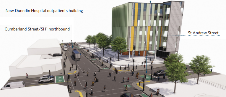

I’ve just fielded a call from the ODT asking for the thoughts of Spokes members on that stretch; they noted that the cycleway is looking to be quite narrow, and that this might concern people who are cycling quite a bit:
The mock-up from the recent consultation update from the NZTA looks quite reassuring on this front:
What do you think? Photos of the current status deeply appreciated!

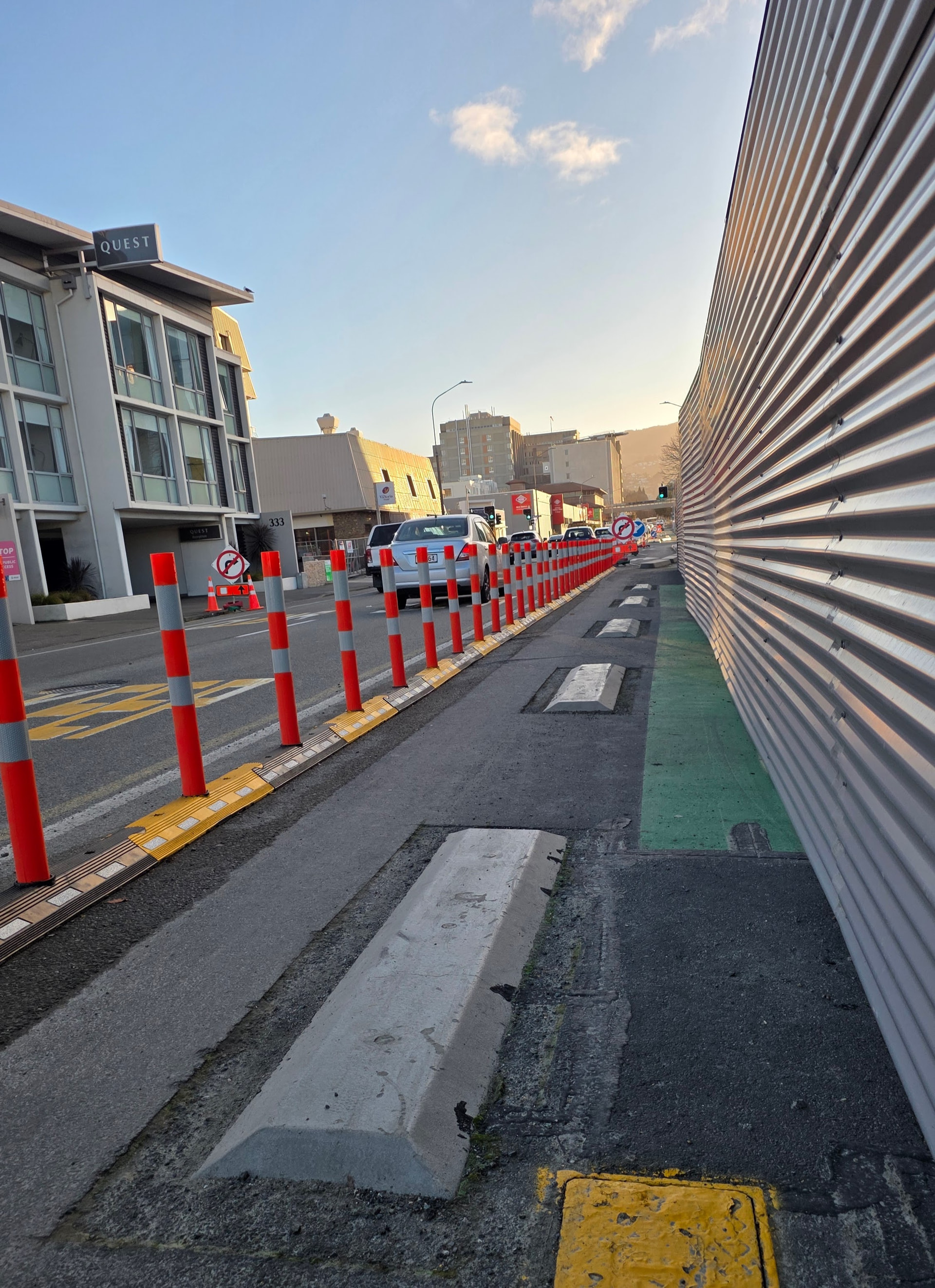

I’ve just taken a look this morning and can confirm the the Southbound SH1 is fine, but the Northbound SH1 has two big issues (both identified in @GerardH’s video above) that really need urgent remediation:

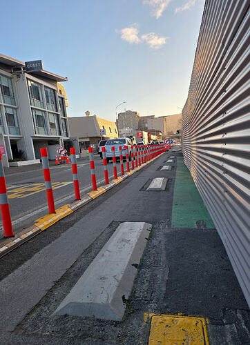

1/2 ‘Tim Tams’ in the middle of the cycleway
Over halfway along, there are old 1/2 height Tim Tams smack bang in the middle of the temporary cycleway, which present a particular hazard for those towing children, disabled cyclists, and those on micromobility:

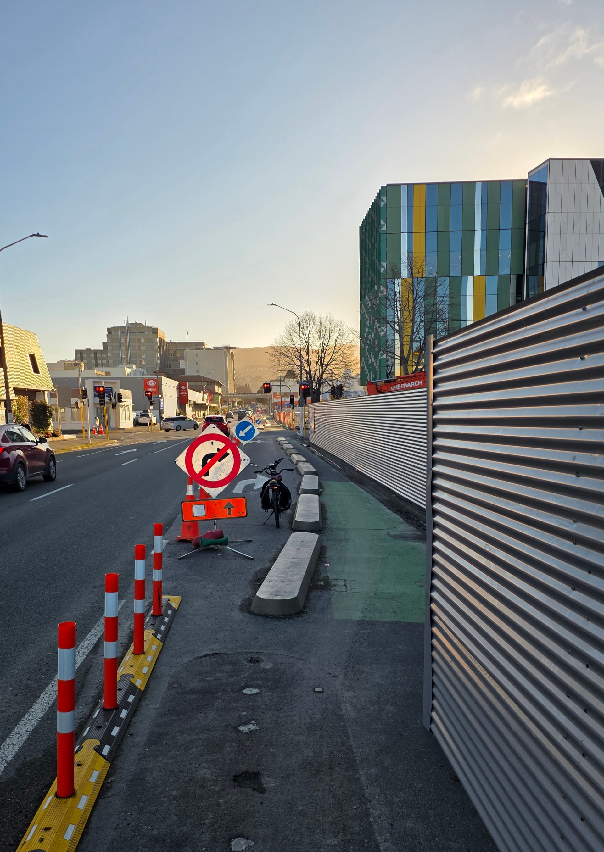

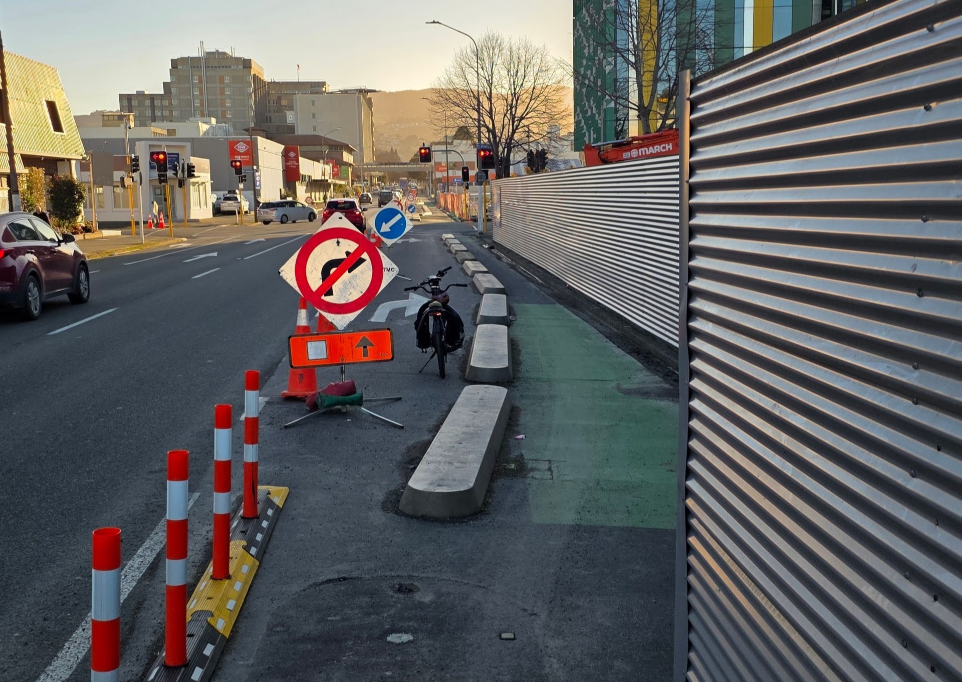

Pinch point
This is a bit further along, where the fence / old Tim-Tam interaction is terrible. It is a crash waiting to happen, again more acute for those towing children, disabled cyclists, and those on micromobility:
Remediation
I spoke with the Project Manager of the inpatient build (Jason Tutty), and showed him the photos and video. He agreed that these are significant problems, and we discussed several constructive ways that they could be mitigated, e.g.
  1. Possibly removing the 1/2 Tim Tams
  2. Alternatively using ashphalt around them to reduce their impact
  3. Changing the fence arrangement to eliminate the pinch point
  4. Placing something on the ground to lead people away from the exposed large Tim Tam
He certainly seemed to take what we discussed with appropriate gravity, and I look forward to seeing these mitigations shaping up soon.

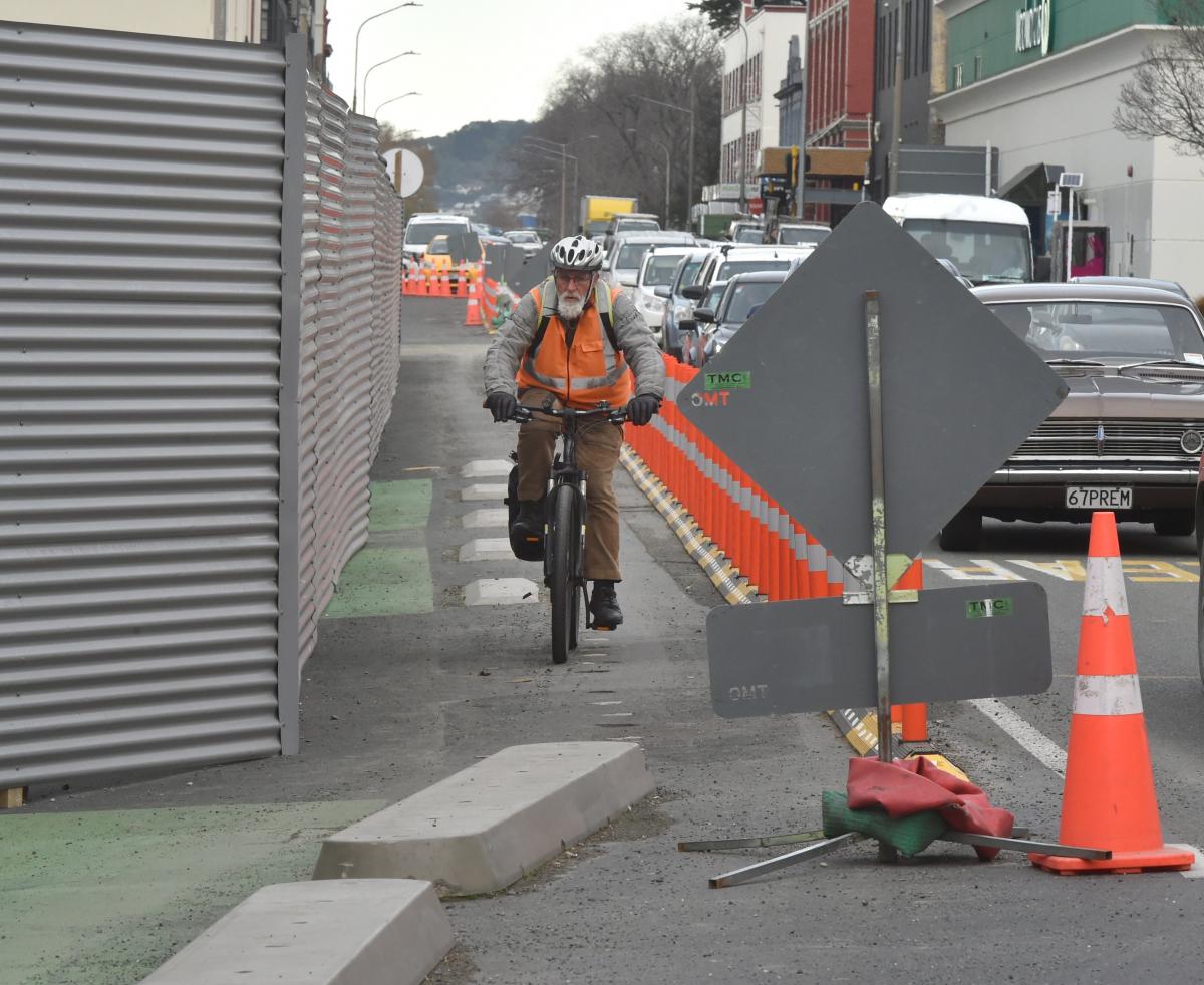

And the article in the ODT:
Nice pic of the pinch point!!!

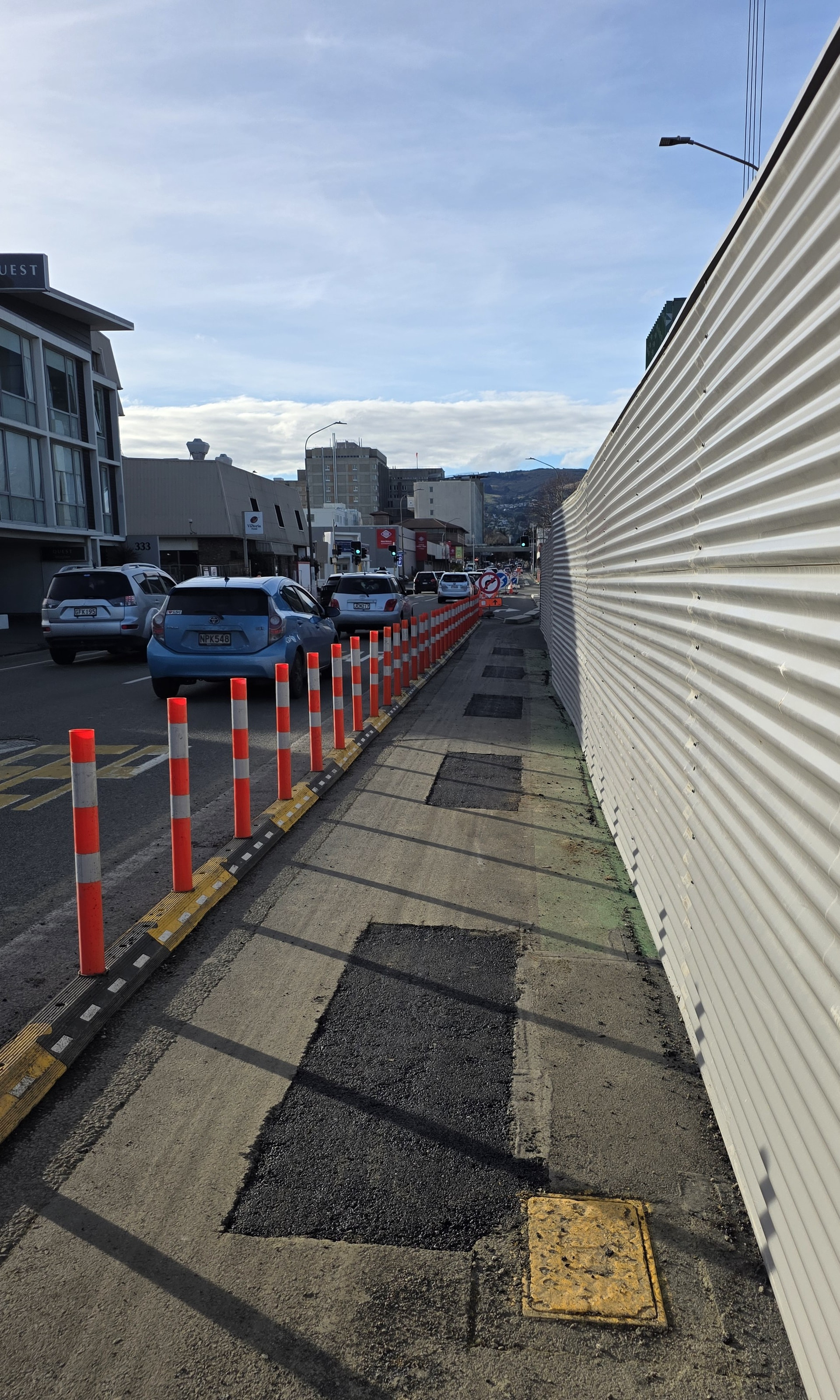

I’m delighted to report that the 1/2 Tim Tams have been lifted now; this markedly improves this troublesome SH1 N section:
It is wonderful to have been listened to!

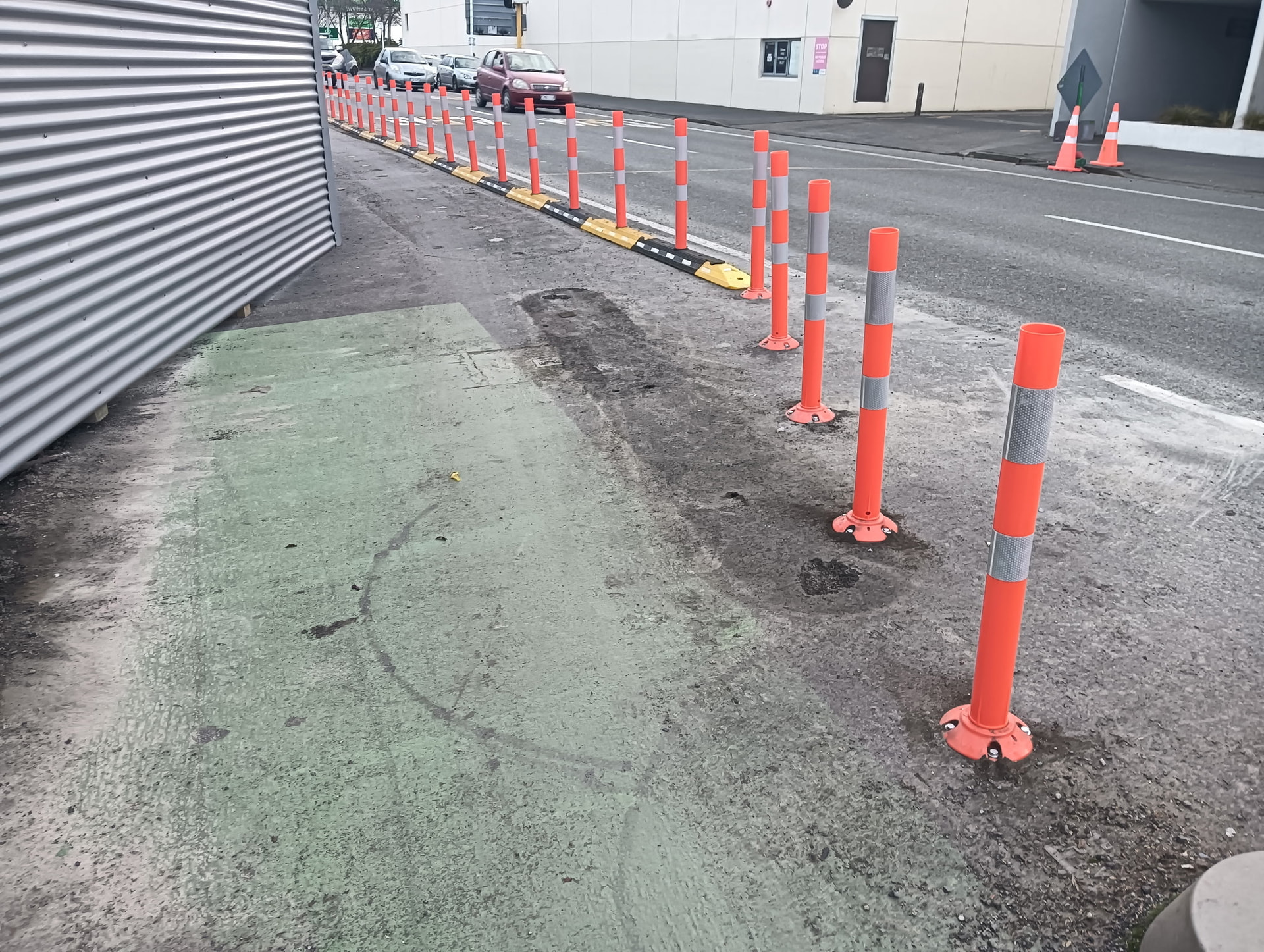

I’ve just touched base with the build team, and they plan to change the layout of the last bit (i.e. where you are heading directly at a large Tim Tam after the section above) so that it is a straight run to the intersection instead.
This might take a week or two to do as they have a lot to juggle along both roadways, but it will get there.

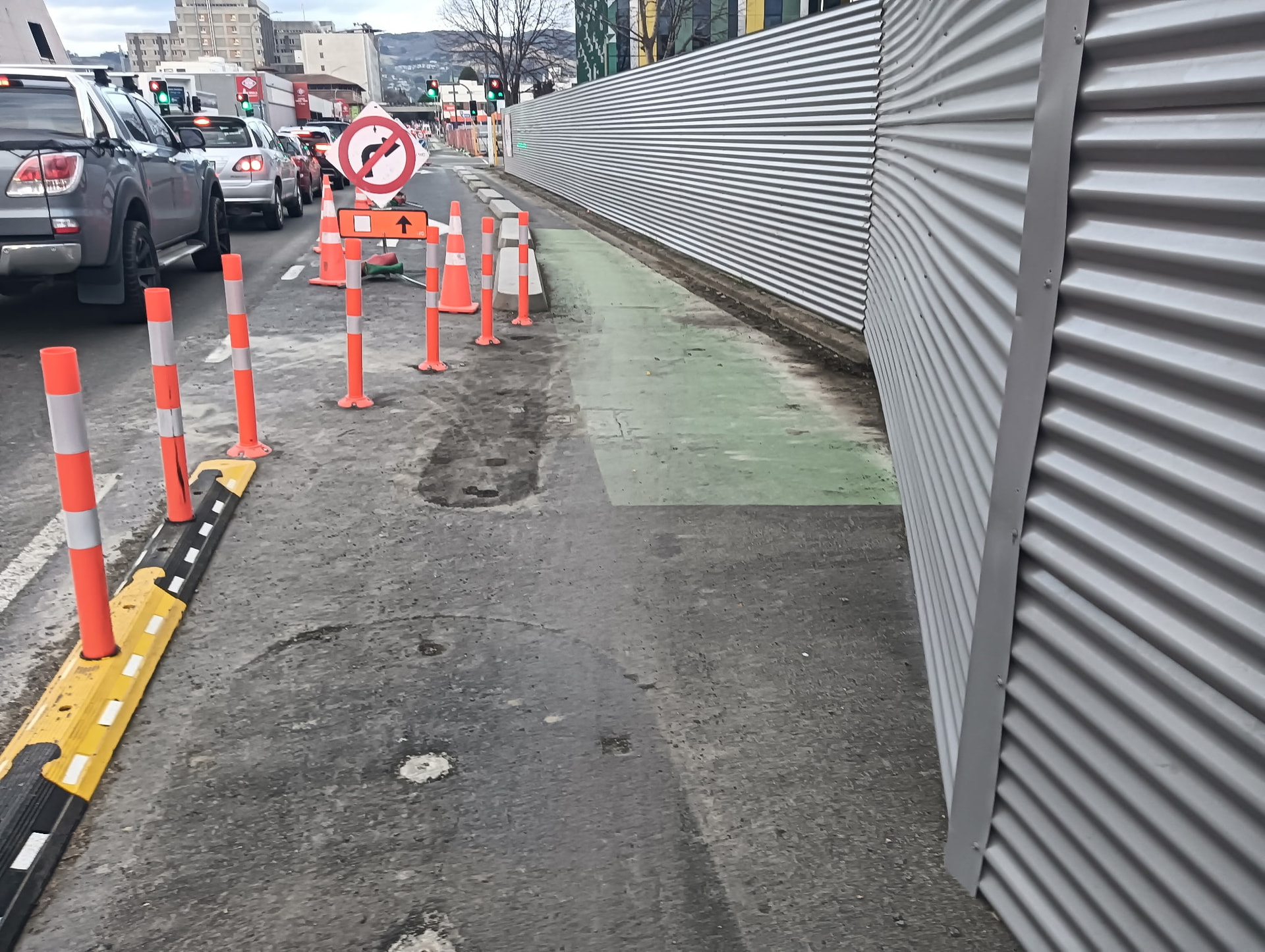

And - another development! The last offending Tim Tam is out:
@GerardH and @heike - have you seen this?
Rode through last night - much much easier! Please pas on my thanks to the NZTA rep.
